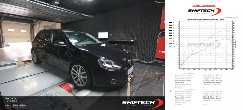

Reprog By shiftech :
Origine: 161.1ch/248Nm
Reprog: 203.7ch/278Nm
